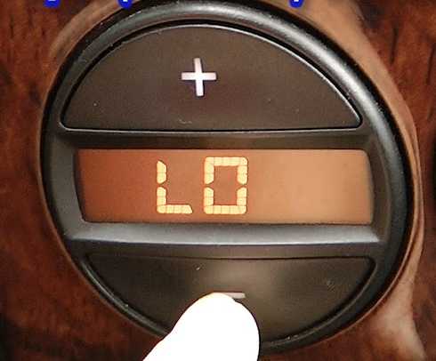

      Dear Opel Friends,
      I am using Opel Vectra B. Since last week the Temperature Unit LED Display (below image) stops working which makes it difficult to read what temperature is set i.e. 20, 21, 21, 22, 23 etc. It’s only the LED light which stops, temperature increase and decrease works fine. Can anyone please advise where exactly is it’s connection/fuse that I can look for and replace it accordingly?
      Screen Shot 2018-01-09 at 11.24.22
      Brgds, Lalit

        It is not led but classic bulb, fuse is ok, bulb is broken.

          Thank you dear! Any reference/instruction link how to open this panel so that I can change the bulb?
